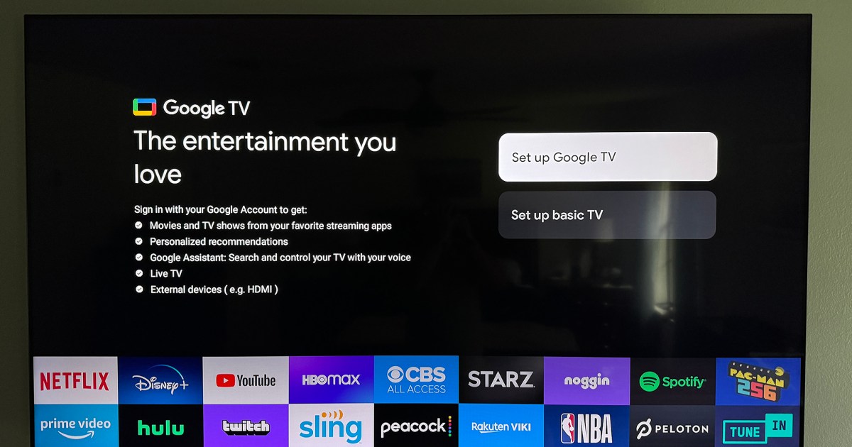

Otherwise you can do what I do : I have a «smart» tv (google tv) but I never logged in to a google account on it, never connected to the internet (if a firmware update is necessary I download the file on my pc and put it on an usb stick to install on the tv), I deactivated all unnecessary background processes and pre-installed apps and I… actually never used the «smart» interface of this TV. I only use it as a dumb tv to game and watch my tv shows or movies from my home server. In a perfect world I would love to be able to erase the google tv system of the tv and replacing it with something open source and privacy oriented.

I had never actually looked into an apple tv 4k, it makes sense to use something like that instead of the tv itself. I found this article below on reasonably priced tv’s that can be pretty “dumb”, and off line:
Might be just the ticket with an apple tv 4k!
